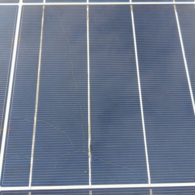

5. Micro-cracks and hot spots
Most modern solar panels are made using a series of solar cells made from ultra-thin crystalline silicon wafers. The wafers are typically around 0.16mm thick or about twice the width of a human hair. Naturally, the wafers and cells are quite brittle and can crack or fracture under high mechanical stresses like mishandling during installation, extreme wind loads or large hail. It’s worth noting that not all cells are brittle; the high-performance IBC cells used by Sunpower are much stronger due to the large array of back-contacts that reinforce the cell.
Minor micro-cracks forming in a solar cell can lead to hot spot formation over several years
Any unusual loads or stresses, such as people walking on solar panels during installation or maintenance, can lead to micro-cracks, which can create hot spots over time and eventually lead to panel failure. Micro-cracks can also form during transportation, impacts, dropping or rough handling.
Micro-cracks
Micro-cracks can be hard to detect and are often invisible at first. Tiny fractures in solar cells are often visible on older panels and will appear as snail trails on the surface of the cell. These fractures do not always cause a significant problem, and the panel may still perform well for many years, even with several fractured cells. However, micro-cracks will start to become a more serious issue if they increase the internal resistance and break the flow of current, leading to a hot spot or hot cell. This is particularly problematic if a micro-crack is large or forms across the entire cell. Fortunately, most modern solar panels now feature half-cut cells with multi-busbars, which significantly reduces the detrimental effects of microcracks. Also, shingled cell panels such as those from Hyundai and Sunpower are generally not susceptible to micro-cracks due to the unique overlapping configuration.
